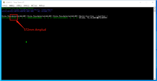

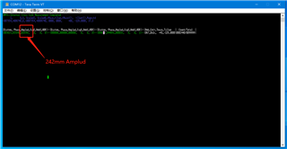

        1:Open the INLAB_STEP_0 conditional compilation instruction in SDK to test whether the calibration distance meets the amplitude condition, but the serial port output contains data in addition to channel 1 and channel 3. Is it correct?
      The calibration distances I found in this step are 242mm and 572mm:

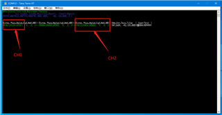

    I don't understand why in Auto HDR, calibration step INLAB_STEP_0 has data in CH2 channel

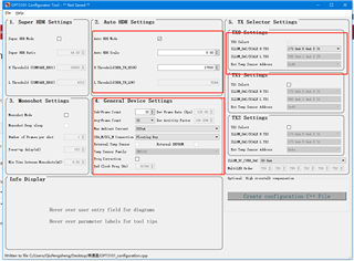

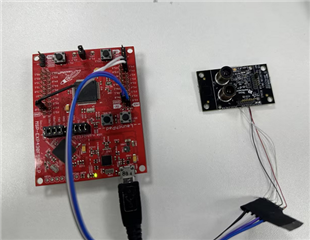

           In my test, MSP-430F5229LP+OPT3101EVM was used for Auto HDR mode test
          OPT3101-ConfiguratorTool :
          Open SDK conditional compilation INLAB_STEP_0, there is a problem in the serial port print-out data, resulting in an exception in the calibration process;
          At this time, my EVM board was fixed, and there was an abnormal data in the middle of the amplitude value printed by the serial port, which caused my calibration failure;

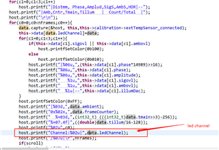

          I added a print LED channel to the SDK print code and configured a single channel, but TX2 appeared in the print information
