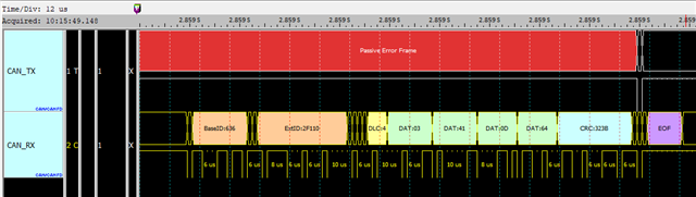

The measurement wave line received two pieces of data, but did not trigger the interrupt DRX (Message Stored to Dedicated Rx Buffer)
Print the value of intrStatus as follows
intrStatus = 0x80

    The intrStatus of 0x80 means that a message was lost, which can be thrown if a FIFO overflows. There is likely some issue with filtering here. A couple of questions:
    Are you running one of our MCAN demos? And have you made any modifications to it?
    Does the ID match the ID used in the your project code?
    The MCAN users manual has a good diagram describing the filtering process: See page 77 https://www.bosch-semiconductors.com/media/ip_modules/pdf_2/m_can/mcan_users_manual_v331.pdf
    Is accept non-matching frames set to 0? Even if we are using a buffer and not a FIFO, if there is a non-matching frame and accept-non-matching-frames is set to 0, it could still be sent to the FIFO and reported back as a overflow/lost frame.

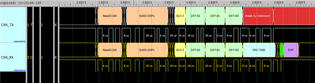

  • The previously uploaded image was compressed by the system, so we use a link instead:
    drive.google.com/.../1nbQq_MVXcIlSW1ja3pvC_7EhTwhPIIzN
    Yes, I have set the extended ID mode. In fact, looking at the measured waveform picture, the Base ID is 0x636 and the Ext ID is 0x2F110. We cannot change the ID because it is a standard established by the automotive OBDII.

    A couple more points and questions. If you are using buffer only mode, you can only use 1 ID at a time. You have EFID1 and EFID2 set up here, so you'll need to make some changes. If you want to receive 0x2F110, then you need to swap that ID over to EFID1. EFID2 needs to explicitly be set to 0x0 as well.
    Please base your register values on the following from one of your previous posts:

    Please also ensure EFEC is 0x7 still as well.
    One last question. If we concatenate the Base ID 0x636 and the Ext ID 0x2F110 we get 0x18DA F110. Why then, is the ID we are using 0x98DAF110? Can we change it to start with a 1 as a sanity check?
    Tim
