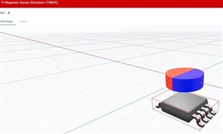

Hello team,
Customer is working on the magnetic design(Simulating the magnetic component spinning) with TIMSS simulation tools. however, it looks that the final position can be set on tool, but Final Angle can not be able to set, thus error is happened as below. May i consult with you how to set it?
    Thanks for posting to the sensors forum.
    It looks like the current "function", or motion the customer has chosen for the simulation is linear motion.

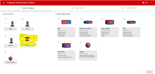

    In order to simulate the rotation of the magnet, the customer needs to select the "rotation" function when starting the design, as shown below. The "hinge" and "joystick" functions can also simulate types of motion that involve rotation.
    Once rotation is selected, the final angular position of the magnet can be set, as shown in the screenshot below.
