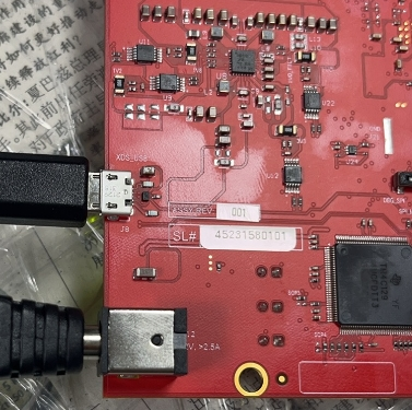

Dears,

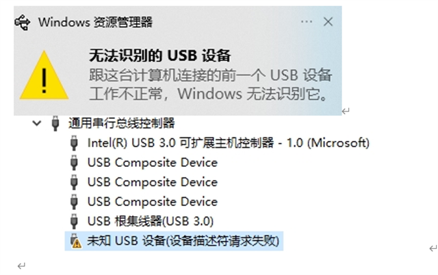

   USB port (XDS_USB) Connect the USB cable to the computer, and an error message will be displayed after power-on. The USB cable also comes with the development board, and our driver has been installed. Using the existing AWR2944 DEMO board, the serial port can be identified and normal debugging can be performed;
Customer have checked the EVM UG 2.3 section, the LED is normal after power-on, we have tried to press the reset button, and we have changed the computer, but the previous error is still indicated.
    Please refer to section 2.8.1 and 2.8.2 in the 2544 LOP EVM user guide for your query. Basically, if PC is unable to recognize the XDS110 ports, then you have to install the latest EMU pack and if the PC doesn't recognize the FTDI ports, then you have to install the latest FTDI drivers.
