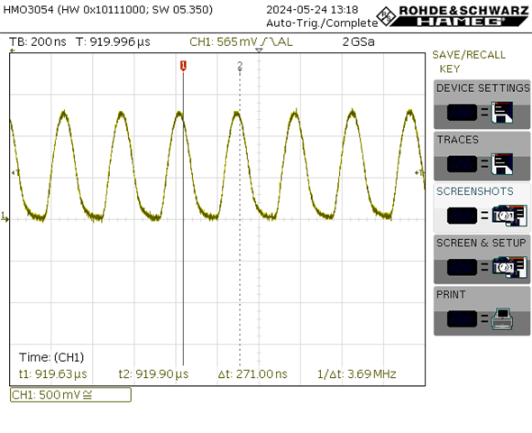

After connecting the LC-circuit to the FDC (with traces, as short as possible and not surrounded by copper while the LC-circuit is not surrounded by copper as well) we encountered a problem: The resonance frequency shifted significantly, now reaching only about 3.7 MHz. Signals are shown in the attached image, but also over I2C we measure this frequency.

    • Do you know the capacitance of your scope probes? The capacitance of the scope can impact the frequency of oscillation. Do you read out different values over I2C when the scope probes are not connected?

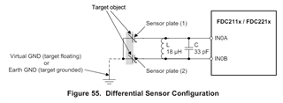

    • You mentioned using the differential sensor configuration. Does your schematic match what is shown in Figure 55 of the FDC2x1x datasheet?

    We disconnected the sensor electrodes to further isolate the problem. Measuring the frequency with our oscilloscope probes now results in a frequency of 3.8MHz. The probes have a (rated) capacitance of 13pF. When disconnecting the probes, and analysing the frequency over I2C, we get 4.6MHz. When using I2C with the probes connected, we read 3.7MHz.

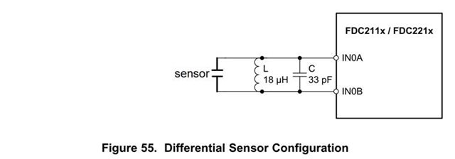

    Not exactly, we use the sensor to detect, if the 2 electrodes of the sensor get closer together, so the circuit looks like this:

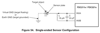

    To detect if the two sensor electrodes are getting closer together, you may be better off grounding one of the electrodes and using the single-ended configuration, as shown below
