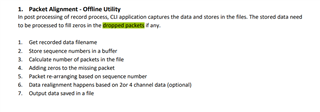

    I have now analyzed the problem by recording with both the capture tool inside the radar toolbox mentioned by you as well as the mmWaveStudio. To compare the transmitted data I have mainly relied on Wireshark, as at least the size and structure of the transmitted UDP packages seems to be consistent between these methods.
    Using mmWaveStudio: When requesting data using the same .cfg file as mentioned before (i.e. 10 frames), the received number of bytes is actually 621*1456=904'176 instead of the expected 1'075'680, so significantly lower than when using my Python script.
    With the capture tool by TI, one can set the number of frames to display at the end as well as the time to record. When setting the number of frames to record via the .cfg file to 10, the number of received bytes is equivalent to the mmWaveStudio case. When requesting the tool to display 10 frames, the matlab script throws an error (which makes sense, as there is not enough data for 10 bytes). The tool works best if the number of frames in the .cfg file is set to 0 (=infinite number of frames). In that case, the requested number of frames can be plotted without difficulty (given the recording time is long enough).
    Analyzing the matlab script at ti/radar_toolbox_2_10_00_04/tools/Adc_Data_Capture_Tool_DCA1000_CLI/gui/rawDataCaptureGUI_DCA1000CLI.m, I conclude that the DCA sends the full data as expected (i.e. the set number of ADC samples for every tx, rx, loop, frame, etc.) but potentially does not transmit some of the values at the end. Is that assumption correct? Is there a specific reason why this is done?

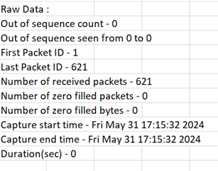

  • HI, Selvin:
    From the recording_005_Raw_LogFile.xml recorded with capture tool,  the number of zero filled bytes is all zero.
    So, there is no missing data during the capture.  Therefore I agree with you, it must be the last sets of data is not transmitted.  Do you have to be that precise?  Could you program to capture 12 frames, and then process only the first 10 frames.

  • Hi Zigang
    Thanks for the quick response.
    It is generally no problem if I have to request more frames than I actually need. I just want to be sure that the data that I do receive belongs to the frames I am interested in (i.e. there is no data missing somewhere in the middle).
    Can you thus confirm that I can trust the data I receive as long as I make sure that all packets are received (by checking their ID)?
    Selvin
  • Hi, Selvin:
    You are right.  I would recommend you to read the documentation under the following folder.
    C:\ti\mmwave_studio_02_01_01_00\mmWaveStudio\ReferenceCode\DCA1000\Docs
    Zigang
