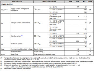

Can you please provide the output rated current and rated power for this part?
  • Hi Deeksha,
    Output specs can be found in the datasheet section shown below. IOH and IOL are the max specs to be able to achieve the VOH and VOL levels shown in the table.
    When it comes to power consumption of the device itself, this will highly depend on the use-case of the device. In general, you should use the average current consumption spec for any power consuption calculations:
