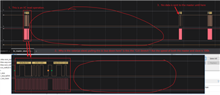

    Below is the data captured with the logic analyzer. I want the radar(iic slave) to return 0xaa,but it was 0x00.
    My question is which register to set when the master initiates the communication so that the slave correctly returns the value of txBuffer?
    Can u share one example include code work on radar as slave, and code work on master to read the radar slave?

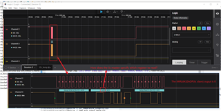

    I used three methods(anther IWRL6432AOP、other MCU、a usb to iic converter) to be the master, and they all showed the same bus pull down phenomenon.
    In addition, the slave(IWRL6432AOP) can only send data after it has been pulled down the bus for a certain period of time if IWRL6432AOP is also acting as the master. However, when mcu and converter act as master, after the bus is pulled down, SDA and SCL are always low.
    It is likely that the observed behavior of the I2C signals is clock stretching. How long is the period that the clock is pulled low? Is the stretch time consistent or does it vary greatly? Keep in mind that an ACK will involve pulling the SDA low, so its possible that the SDA and SCL are both held low due to clock stretching.
    Kristien
  • As I said before, the slave(6432) will only send data if 6432 is also acting as master. In a complete read operation, the bus pull down time is as follows:9ms and 42 ms. Each period is fixed.
    Have you tried using 6432AOP as an iic slave? Can the data transfer normally? After your test is completed, can you give an example of a slave? Hopefully there will be a clear result.

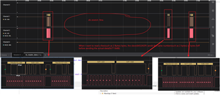

  • Yes, my code is currently modified based on the iic_read project.The ”clk stretch“ phenomenon occurs all the time as follow:
    Also, I'd like to see the complete  timing diagram of a read operation.
    And here is the  complete code (iic_read.c):
    Could you provide the timescale/axis for the reading on your logic analyzer?  From what it looks like the clock stretching isn't apparent, so I wanted to see the time axis as well for comparison
    This is the complete timing diagram.  The device software that we used for testing simply sends a controller(master) read and we captured the behavior as the read happens.  Prior to this, both the SCL and SDA lines are pulled high.  The only difference between your example and mine is the length of the buffer and write count, both are 1.
