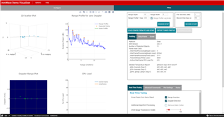

4. send commands ti\demo\awr294x\mmw\profiles\tdm_awr2944\profile_LVDS.cfg to EVM
Result: ADC data captured
