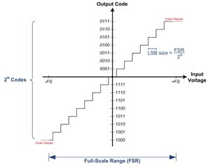

According to E2E article from TI, LSB=FSR/2^N where N is the ADC resolution.
Q1: What is the LSB of ADC in xWR6843?
Q2: What is the reference voltage for the ADC in xWR6843?
From my study the threads on E2E, understand some feature of the ADC in xWR6843
I try to calculate: If considering 12-bit ADC mode, The positive peak voltage at ADC input is 1V. The output is 0x7FF in HEX = 2047 in DEC.
Q3: Then the LSB = FSR/2^N=2/4096=0.000488V=0.488V?, or should I calculate as 2/2048 = 0.244 V?
Q4: There are "minus Full-Scale area" at the left bottom. Will there also be related code word? Does 0x000 corresponds to 0V input or -1V input?
