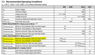

    1. Yes, there are two modes of operation depending on the measurement range.  For your application, you will be using mode 2.
    2. Yes, the device allows for more than 1 stop signal.  Please note the specification highlighted below regarding the min time between two stop signals.
    3. Yes, that is doable.  Note that typical accuracy in mode 2 is around 28ps.
