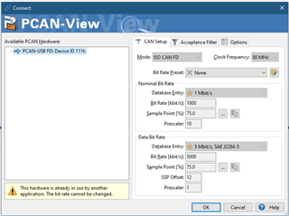

    Isn't the automotive visualizer supposed to display the data output from the CAN lines? (at least that is how it seems from the user's guide)
    There are also no CAN parameters listed in the user's guide, but from looking through the code, I came up with these:
    However, after sending the configuration with the automotive visualizer, then connecting on PCAN-View, there is no activity on the lines. (using CAN instance A)

  • Hi Richard,
    Yes, you should be able to see the plots in the visualizer. As you have already said that you don't see any output, I asked you to check it in PCAN-View.
    Instead of using the visualizer, send the configuration through some terminal emulator like Tera Term and check the output using PCAN-View.
    The bit rate, clock frequency that you are using is correct.

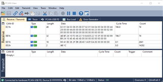

    I tried this with the 2944 OOB Object Data over CAN, and received this:
    And then no other data was streamed. The config file I used was "profile_3d_3Azim_1ElevTx_DDMA_awr2944_highRange.cfg" from the radar_toolbox_2_10_00_04 2944 OOB Object Data over CAN example.
    Where can I find what this data means?

  • Hi Richard,
    In profile_3d_3Azim_1ElevTx_DDMA_awr2944_highRange.cfg, all the parameters are 0. So, you didn't receive anything other than header.
    Check radar_toolbox_<ver>\source\ti\examples\2944_OOB_object_data_over_CAN\src\2944\include\mmw_output.h to understand the format of header.
    To understand different parameters of the commands in the configuration, refer to "C:\ti\mmwave_mcuplus_sdk_<ver>\mmwave_mcuplus_sdk_<ver>\docs\mmwave_mcuplus_sdk_user_guide.pdf".
    How many frames did you configure? You have received the header only for 1 frame.

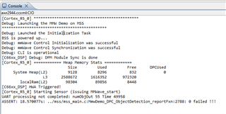

    However, just in case, I changed it to 100 to see if it would stream out 100 frames, and it did not. This is the image of what streamed out. I think something else is going on here.
    Anyways, I loaded the project into CCS and ran it in a debug session, with the same setup (same configuration over UART, and CAN connection), and when I sent the configuration, I get this:
    And this on the CAN stream.
    It seems there is some other problem going on.
    For which example did you test this? In 2944 OOB Object Data over CAN demo, the object data is not sent over UART. In my previous reply, I was referring to Nonos OOB demo (DDM).
    Yes, I was also talking about the Nonos OOB demo (DDM). On here, the detections should stream out over UART, right? That is how it is supposed to work with the demo visualizer, right?
    This issue occurs when the transfer is not completed. There is a macro - CAN_STREAM which is defined in this demo. If this is not defined the object data will be streamed over UART. So, the log UART(/CAN) processing not completed means the previous frame's transfer is not completed.
    I don't see such issue when I run this demo. Check if the CAN-USB connection is disconnected between the transfer. Do not provide any breakpoint while running the demo as the transfer will not be completed.
