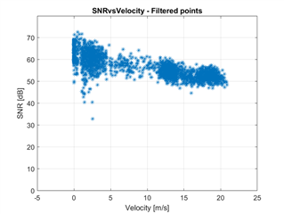

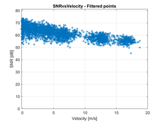

When assessing our Doppler radar sensor, which utilizes the IWR6843 chip, we observed that the Signal-to-Noise Ratio (SNR) varies with velocity.
According to our findings, there appears to be a correlation where an increase of velocity by 3 m/s corresponds to a decrease of SNR by 1dB. We're unsure if this phenomenon is widely recognized as a standard behavior in radar systems, as we haven't found relevant literature discussing it.
We're curious about the underlying reasons behind this relationship. If you have any insights or suggestions, we'd greatly appreciate them.
    Can you please share more about these findings? As velocity continues to increase do you see a continued decrease in SNR? Was this testing performed in an anechoic chamber? How are you generating a specific velocity?

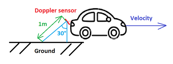

  • Sure, there are a few measurements we have conducted:
    Our tests were car tests, where we have attached the doppler sensor approximately 1m above the ground.
    Velocity is generated by the car movement.
    Thank you. Can you please clarify further?
    Is the sensor attached to the car? If so is the sensor pointed directly at the ground or is the sensor pointed outward?
    Or do you mean the sensor is mounted in a fixed position and a car drives in front of it?
    Josh
  • The sensor is attached to the car and is pointing to the ground at approx. 30° angle.

    Thank you for the diagram and additional info. So just to confirm, as the velocity increases, the distance between the radar and the ground remains the same, correct? Also, in the plots that you have shown above, is it true that they are including data which is compiled over a long time (multiple frames) or they are representing the SNR vs Velocity of every point in a specific frame?
    Josh
    yes, the distance between the radar and the ground remains the same.
    Each point represents single radar measurement. Each plot represents different CAR test.

  • Hi Pavel,
    My sincere apologies for the delay. Is there a specific reason that you do not use the latest version of the MMWAVE-SDK (3.6)? I'd be curious to know if you observe the same phenomenon in your tests with the updated version.
    Regardless, one potential explanation could be ‘range migration’. The radar measures a scene in finite time – for example a 15 ms active frame-time (with 128 equally spaced chirps) could be  used to sample a scene with a moving target.
    During that 15ms the target moves by a certain distance (‘range migration’), which would reduce its SNR compared to how it would be if the target was standing still. In some cases the targets velocity could be so high that it moves from one range-bin to another.
    There should be ways to compensate for this… you could estimate the targets velocity and then re-process the data after correcting for the targets velocity. At the moment, none of our example demos implement this compensation but it is something you could explore if you wish.
