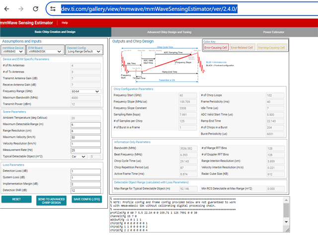

When I make .cfg file by using demoVisualizer, it seems that slope(MHz/us) value always under 100MHz/us, but regarding IWR6843, I think up to 250MHz/us is available.
Is the slope value restricted in the demoVisualizer?
If it is true, why is the slope value restricted?
I am using demoVisualizer ver.3.6.0.
