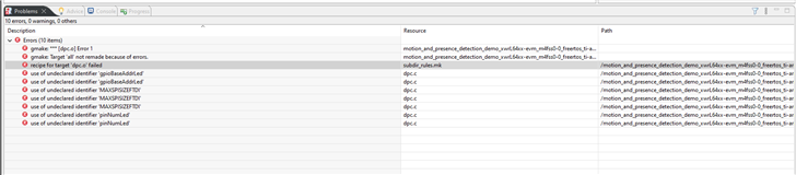

    Thank you for your guidance.
    I have looked at the Document, and am trying to enable ADC STREAMING via SPI in example.sysconfig through CCS.
    I newly imported motion and presence detection demo through Project Wizard. I did not change anything but enabled the ADC STREAMING.
    However, I cannot successfully build the project, showing error.
    Which project am I supposed to import to enable and build successfully with ADC STREAMING via SPI enabled?

  • Hello.
    Apologies for the delay in response.  Please add the following two lines to dpc.c
    #define MAXSPISIZEFTDI (65536U)
    extern uint32_t gpioBaseAddrLed, pinNumLed;
