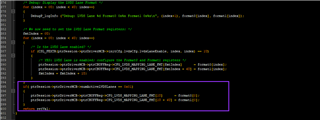

  • yes, the problem is if set lvds lane enable to 0x02,  MmwDemo_LVDSStream_HwTriggerFrameDone can not be triggered correctly.
    /* Populate the configuration: */
        sessionCfg.executionMode          = CBUFF_SessionExecuteMode_HW;
        sessionCfg.edmaHandle             = gMmwMssMCB.edmaHandle;
        sessionCfg.allocateEDMAChannelFxn = MmwDemo_LVDSStream_EDMAAllocateCBUFFHwChannel;
        sessionCfg.freeEDMAChannelFxn     = MmwDemo_LVDSStream_EDMAFreeCBUFFHwChannel;
        sessionCfg.frameDoneCallbackFxn   = MmwDemo_LVDSStream_HwTriggerFrameDone;
        sessionCfg.dataType               = CBUFF_DataType_REAL;
        sessionCfg.u.hwCfg.dataMode       = (CBUFF_DataMode)subFrameCfg->adcBufCfg.chInterleave;
    if set lvds_lane_enable to 0x01, it works correctly.
    what's the difference with these two configurations?

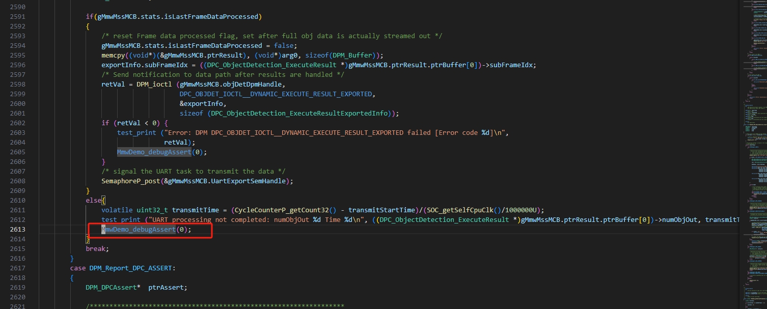

  • If change lvdsLaneEnable to 0x02, in default application
    it logs as the following:
    It locates :
    which means 'gMmwMssMCB.stats.isLastFrameDataProcessed' is not correctly set
    BTW: set lvdsLaneEnable to 0x01 works well

  • Hello Liu,
    So, I identified the issue due to which the application was not working:
    First go to the file: C:\ti\mmwave_mcuplus_sdk_04_06_00_01\mcu_plus_sdk_awr294x_09_00_00_15\source\drivers\cbuff\v0\cbuff_lvds.c
    In CBUFF_openLVDS function, modify the last section of this code:
    This is just a fix only for 2nd lane as I have hard coded the values.
    Then rebuild the library using the command:
    gmake -s -f makefile.awr294x drivers_r5f.ti-arm-clang drivers_c66.ti-c6000
    Then rebuild the application again.
    This should make the application functional now.
    Saswat Kumar
