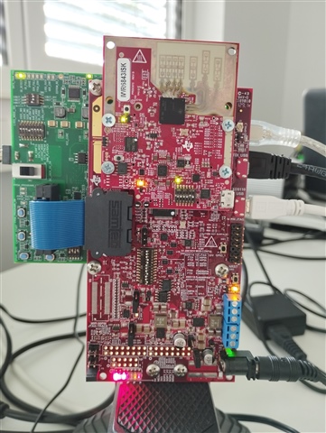

I am using the IWR6843 ISK sensor and I am having trouble starting it. Below is the log file from the configuration port generated by my Python script. I don't understand what the error code -1 means or how to resolve the issue. I also tried using PuTTY to start the sensor, and after sending the full configurations,and receiving a 'Done' response, with sensorStart command returned an error code of -1.

    these are the information i got when I connect to the config port
    port info: COM3 -> {'Platform': 'xWR68xx', 'mmWave SDK Version': '03.05.00.04', 'Device Info': 'IWR68XX QM non-secure ES 02.00', 'RF F/W Version': '06.03.02.06.20.08.11', 'RF F/W Patch': '00.00.00.00.00.00.00', 'mmWaveLink Version': '01.02.06.06', 'Lot number': '4325209', 'Wafer number': '6', 'Die coordinates in wafer': 'X = 15, Y = 32'}
    and I am using this profile epiwatch_3x.cfg

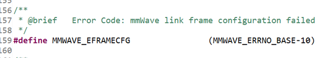

  • Hi Helen,
    My sincere apologies for the delay. I was able to reproduce the issue you are seeing. When debugging the demo in CCS, it gives the error code -3110.
    This equates to mmwave link frame configuration error.
     (mmwave.h)
    The issue is that the framePeriodicity is too small. With the frame period set to 25ms (frameCfg 0 2 32 0 25 1 0) it is actually smaller than the active chirping time which is calulated as ( (idleTime + rampEndTime) * numTxAntennna ) * numChirpLoops. In the configuration you shared the active chirping time comes out to ~27.8 ms (>25 ms frame time). The frame period should account for the full active chirping time + some additional time for further processing and transmission of output data.
    Josh
  • Hi Josh,
    I am really thankfull.increasing the frame period resolved my issue
    Greetings
  • Helen,
    I'm glad to hear your issue is resolved. I will close this thread now. Please create a new post for any additional questions.
