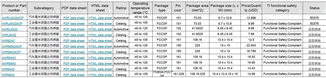

I would like to know more about the parameters of millimeter wave radar
1. What is the maximum supported angle for radar FOV?
2. How many kinds of gesture functions can algorithms support?
3. Is there low power consumption?
4. Can antenna design be supported?

  • Regarding the third point of the content, the power consumption of the old IWR6843 is much higher. What is its specific power consumption?
    Additionally, the example software and other software optimizations mentioned in the "low-power mode" can reduce the power consumption you see in the out of the box demonstration. I'm not quite sure what this specifically refers to?
    The specific power consumption varies greatly depending on the radar configuration (number of antennas enabled, chirping duty cycle, processing time, etc..) but for IWR6843 the average power consumption can range from 0.5-2 W whereas for IWRL6432 it will be more in the range of 3-100 mW.
