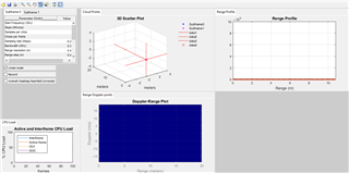

While building Lab_008 - Automated_Parking from radar_toolbox_2_00_00_06 using mmWave SDK 3.6.0.00-LTS, I encountered an error.
unresolved symbol gAntennaSpacing, first referenced in ./objectdetection.oe674
I resolved the issue by adding the antenna_geometry.h file, which was present in the mss filesystem but excluded from build, into the file in the dss filesystem. I also included it in the mss build.
However, upon flashing the bin file onto the board and running the visualizer exe, I encountered a new error and the Matlab GUI froze. I'm also experiencing similar GUI freezing issues with the prebuilt binary, but this time the GUI crashes after 10-15 seconds. Do you have any ideas on how to resolve this issue?
C:\ti\radar_toolbox_2_00_00_06\tools\visualizers\Automated_Parking_GUI>mmw_demo_parking_xyz.exe xwr18xx 18 20 4 17 ../chirp_profiles/profile_parking_mimo_2d_50m_3d_10m_aop.cfg 1

sensorStart
Warning: Unexpected Warning: A timeout occurred before the Terminator was reached.
byteVecIdx =
     0
