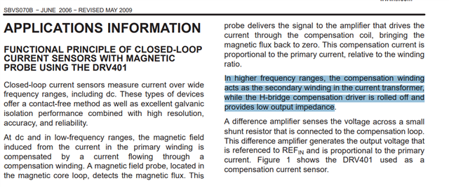

  • Hello ??,
    I couldn't find the information in the datasheet about the bandwidth of the current signal that the DRV401 can measure. I assume this should be related to the frequency of the probe excitation, right?
    This is not correct.  The device uses the probe excitation for lower frequencies and the higher frequencies are measured using the transformer effect from the compensation core.  This information is in the datasheet.  If the core can handle the higher frequency then the limitation will be the difference amplifier.

    1) This document is for the DRV421 which is similar to the DRV401.  See section 2.1.8.  The DRV401 could operate at a different frequency as it depends on your probe design.  This will depend on your compensation core as well.
    2)This from what I have seen is all based on the material and the design of the compensation coil.  We do not have a design guide for this.
