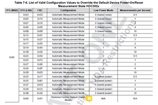

HDC3022: List of Valid Configuration Values to Override the Default Device Power-On/Reset Measurement State
Part Number: HDC3022
I have a question regarding Table 8-4 'List of Valid Configuration Values to Override the Default Device Power-On/Reset Measurement State' for the HDC302x. It is mentioned in the datasheet that the configuration data is 2 bytes and the CRC is 1 byte. However, the first and second column names in the table are given as CFG (MSB) and CRC (LSB). It is to be noted that CFG (LSB) value is not given.
1) How can we get the value of CFG(LSB)? Is it a typo in the second column as it is mentioned as CRC(LSB). I suppose the CRC needs to be calculated based on the MSB and LSB of CFG data.
2) If the second column is actually CRC, how is it calculated? What is the CFG(LSB)  value for this CRC calculation?
