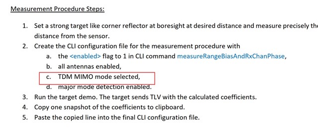

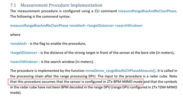

My customer found the different between the two contents in red boxes below:
For the Measurement Procedure, which mode is correct? In the first box, it says assuming BPM-MIMO mode and then the Steps in the second box is TDM MIMO mode.
Could you please explain that?

  • Hello Moon,
    This is an error in the SDK documentation, it should be TDM MIMO.
