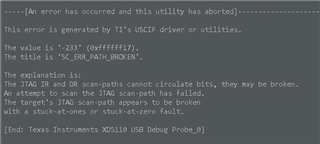

Kindly tell me how to connect AWR6843AOPEVM with XDS110, No ICBOOSTER and DAC1000.
I tried connecting with JTAG pins but it shows the error below!

This looks like JTAG is not connected properly.

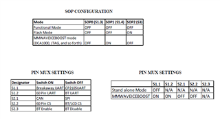

Can you please confirm whether your switch settings match with the below attached image?
If your switch settings are not matching, then kindly match them with the below image and confirm whether the issue is resolved with these settings.

I have kept SOP1(S1.4) ON and other switches are off! is it correct? and I don't have MMWAVEICEBOOST.

Kindly place the S1.1, S1.4 and S2.3 switch settings to ON position and all other switches of S1, S2 and S3 in off position.
Let us know if your issue is resolved with these switch settings.

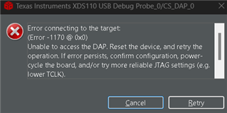

I tried with the recommended settings but still showed the same errors.

You should be able to connect to the JTAG of BLE wireless MCU using the J7 connector.
You cannot use the J7 connector for AWR6843AOP debugging.
On the AWR6843AOP EVM, we only have one provision to connect to JTAG pins of AWR6843AOP device i.e., by connecting the EVM to MMWAVEICBOOST board and placing the switch settings of EVM to MMWAVEICBOOST mode. Or else you will need to perform hardware changes for JTAG debugging. (Depopulate the below shown Resistors - RA4A, RA4B, RA4C and RA4D and connect to these AR_TMS, AR_TCK, AR_TDO_SOP0 and AR_TDI signals)
