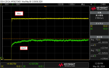

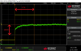

    Using DRV5056A4 at 5V Vcc, I am tying to measure the change in the bias magnetic field (75mT bias) caused by the approach of a soft magnetic material.
    First, I measured the bias magnetic field without any soft magnetic material.
    After power on, the output voltage of the hall sensor increases by approximately 10mV over a few seconds and then stabilizes.
    The bias magnetic field is provided by a nearby neodymium magnet, so it is unlikely that the magnet field has changed within a few seconds.
    One DRV5056A4DBZR and 0.1μF ceramic bypass capacitor are mounted on a 2-layer FR-4 PCB , no other components.
    Vcc is provided by an external regulated power supply.
    Excluding the change of power-on time, what could be the possible cause?

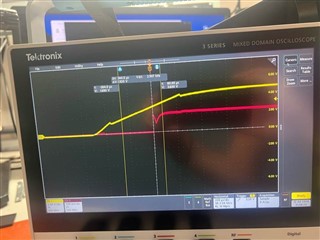

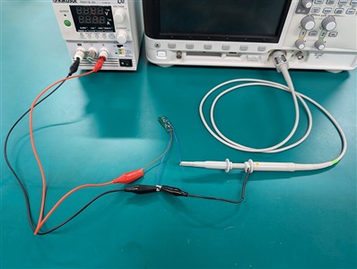

    In a scenario where you are heating up both the magnet and device to a significantly higher temperature, and they are not changing temperature at the same rate, then I would expect a delay like this.  However, for power-on at a stable ambient temperature I would not expect such behavior.  How close are your test points to the device?  Could you possibly provide  a picture of the probe connections?
  • Hello.

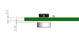

    Here is the probe connections.
    The blue wire on the right is soldered directly to the output pin and is approximately 90mm long.
    The VDD and GND pins are connected to wires through the PCB traces.
    The bias magnet is mounted on the back side of the PCB(1mm thick) with a gap of 0.45 mm.
  • Hey M.H.,
    Thank you for providing that.  We are going to try to do some measurements of our own tomorrow and get back to you.

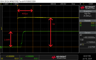

  • Hello M.H.,
    We are having difficulties reproducing what you observed.  In our first test case we power up the device to 5V with no field present.  From that you can see that after VCC reaches 3V, it takes less than 400us to reach a stable vq.
    When we provide a field, it does seem to take longer, however it does seem to reach the output value around 400us.
    Have you observed this behavior on more than one device?  Could you provide a picture of the part top markings?

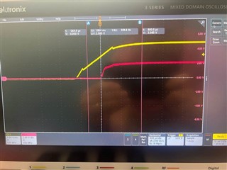

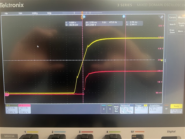

  • Hello M.H.,
    Here are some additional captures we were able to collect.
    Please let us know if there are any questions regarding the captures.
    Isaac

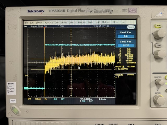

  • Hello Patrick and Isaac.
    Thank you for trying to reproduce.
    I think the problem is that you are measuring the output voltage at 1V/div and I am measuring it at 10mV/div.
    I also measured at 1V/div 200μs/div, and like your results, the output voltage appeared to settle within 400μs.
    Since I intend to measure small magnetic field changes with a hall sensor, I measured the output voltage near its final value at 10mV/div .
    And with that method, it seemed to take several seconds for the output voltage to settle to its final value.
    Here is another result with 10mV/div.
    A difference of 10mV with an output of 2.5V corresponds to 0.4%. Actually, should such a small difference be considered an error?
    In other words, is DRV5056A4 not suitable to measure small changes in a large bias magnetic field(e.g. 0.5mT out of 75mT)?

  • Hi M.H.,
    We were able to reproduce the problem you observed, and we're passing it on to the relevant teams. Thanks for your patience.
