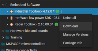

    2. You can get it from the Toolbox on dev.ti.com. Get this specific version of the Industrial Toolbox as I am certain it will work with the ROS Driver: https://dev.ti.com/tirex/explore/node?a=VLyFKFf__4.12.0&node=A__AEIJm0rwIeU.2P1OBWwlaA__com.ti.mmwave_industrial_toolbox__VLyFKFf__4.12.0
    It will be under the old name overhead 3d people counting C:\ti\mmwave_industrial_toolbox_4_12_0\labs\People_Counting\overhead_3d_people_counting\prebuilt_binaries\default
    3. You can find a config in a folder within that labs directory as well.
