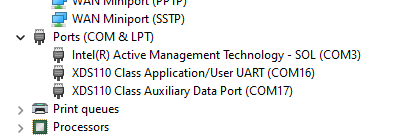

This is probably really basic, but I have not been able to fix it for the life of me. I am trying to use the person detection demo on Matlab, and can not seem to establish a connection to the data port. While using the Hardware Setup from the Radar Toolbox Support Package I am able to flash the binary (or at least get a success message) but when trying to test the connection I just get an error. I tried writing and reading from the data port in a simple script but wasn't successful, and also tried connecting to the port via serial with Putty but was also unsuccessful. I really appreciate your help.
    Can you let me know the specific versions of SDK and/or Radar Toolbox you are using. If you're on Windows, can you check in Device Manager and ensure the serial ports show up correctly as seen here. If the ports look different then it's possible that updated drivers may be required.

  • Hey Josh! Thanks for replying.
    These are the ports I see. I am able to print a message to the UART port.

    Okay I think I understand the issue now. Currently, all of our examples for IWRL6432 do not use both ports. Both the configuration of the sensor and the output of the processed data happens on the 'Application/User UART' port. I apologize for the confusion.
