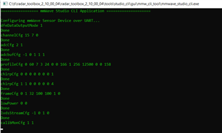

 The first thing I've tried to understand is why there is no response for cli CMD. Theoretically, it should be pretty straight forward as long as the right COM port is selected and the right binary is in place. The experiment that I did was with the following steps
1) disconnect DCA1000 from the ODS EVM
2) flash ODS EVM with mmwave_Studio_cli_xwr68xx.bin and then switch to functional mode (ofc power reset afterwards)
3) Run studio CLI application and get the NO RSP fro CLI CMD error.
4) flash ODS EVM with out_of_box_6843_ods.bin (radar_toolbox_2_10_00_04\source\ti\examples\Out_Of_Box_Demo\prebuilt_binariesand then switch to functional mode (ofc power reset afterwards)
5) Run studio CLI application with the same configuration and get the below Response
My conclusion based on above experiment is that there seems to be something wrong with the mmwave_Studio_cli_xwr68xx.bin. Is it compatible with the IWR6843-ISK-ODS variant?
