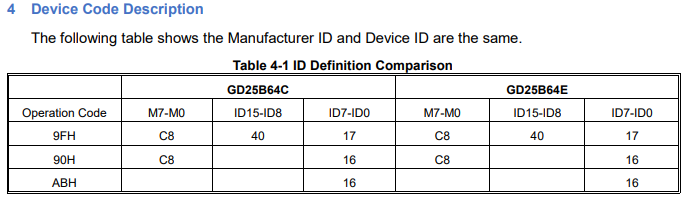

  • Hi Animesh,

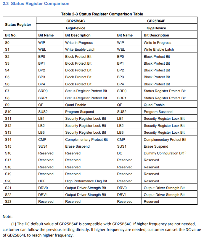

    I have a comparison document directly from the manufacturer of both devices, GigaDevice, that directly compares the operating conditions, performance, status registers, and commands. I've attached the tables to this post for your reference. The only discrepancies I see between the two devices are the following:
    • Status Register Comparison
      • S16
        • GD25B64C: Reserved bit
        • GD25B64E: Dummy Configuration bit
      • S20
        • GD25B64C: High Performance Flag bit
        • GD25B64E: Reserved bit
    • Command Comparison
      • Quad I/O Word Fast Read
        • GD25B64C: E7h
        • GD25B64E: NA
      • Fast Page Program
        • GD25B64C: F2h
        • GD25B64E: NA
      • Read Manufacture/Device ID by Dual I/O
        • GD25B64C: 92h
        • GD25B64E: NA
      • Read Manufacture/Device ID by Quad I/O
        • GD25B64C: 94h
        • GD25B64E: NA
      • High Performance Mode
        • GD25B64C: A3h
        • GD25B64E: NA
    The QE bit is active in the GD25B64E and cannot be changed. Both devices have a flash size of 64Mb and both have the same device ID and manufacturer ID.
    ID.

  • Hi ,

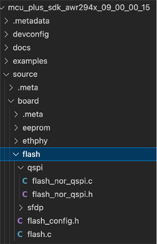

    GD25B64C is already supported and tested flash part with AWR2944 but I understand that due to stock unavailability you need to use GD25B64E.
    And in your comparison list, I see lot of register difference. So effectively you need to port flash driver for GD25B64E part.
    Flash driver is part of mmWave MCU Plus SDK installation
    In this driver you need to have all the required register mapping wrt your flash part.
