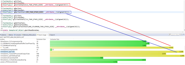

I'm confused about reading stack information from "Stack Usage" in CCS
1. In the BSD demo code, task stacks are defined as follows
CLI_TASK_STACK_SIZE (4 * 1024U)
DPC_TASK_STACK_SIZE (8912)
StackType_t is uint32_t → 4bytes
StackType_t  gCliTskStack[CLI_TASK_STACK_SIZE] __attribute__((aligned(32)));  → 4 * 1024 * 4 bytes
StackType_t  gDpcTaskStack[DPC_TASK_STACK_SIZE] __attribute__((aligned(32))); → 8912 * 4 bytes

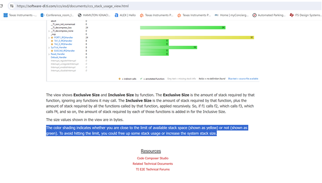

2. this website(https://software-dl.ti.com/ccs/esd/documents/ccs_stack_usage_view.html) says "The size values shown in the view are in bytes"
Why are these two tasks shown in yellow? DPC(2328). CLI(2152)
In addition, size of DPC is twice of CLI.
