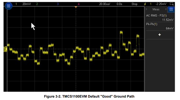

Customer is using TMCS1126A1 on their own board. A1 is 20mV/A. They found that output has a 20mV noise when there is no input, both on their own board and TI demo board.
Do you have some suggestion to remove the noise?

    What is the issue you are seeing exactly for low frequency.  From the question above I had no context of low frequency noise.  Is your issue with the TMCS110x family.  As we have an explanation of that in this application note:  An image below from that application note.
    Can you share what device you are using and a screen shot of the low frequency noise?  Also if you have a definition of low frequency.
