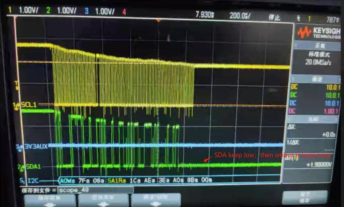

we also met TMP117AIDRVR will keep pull low SDA at the power supply is weak. the waveform as below:
    First, have you been able put the device in shutdown mode normally (without trying to program the EEPROM yet)? If not, please try this first and see if the TMP117 acknowledges communication and enters shutdown mode correctly. If you have any issues with communication, please provide a more zoomed-in scope shot.
    You can use the user-programmable EEPROM to store custom POR values for the conversion mode (continuous or shutdown mode) and other settings. This is detailed in the datasheet section 7.5 on programming. I have copied a flowchart of the programming sequence below. After writing the desired data, it is important to wait the full 7ms, check that EEPROM_Busy=0 (programming complete), then issue a general-call reset.
    I am not sure why the SDA and SCL voltage is going low, maybe there's an issue with the power supply. I would need more information about the schematic and application to give more comment on this.

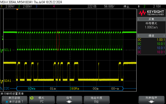

        Yes, we had tried to write register address = 01h: MOD[1:0]=01, but we when we read back MOD[1:0], its value still keeps to 00. How can we know TMP117 whether enter shutdown mode or not? Any register bit or status can be checked to confirm?
    Which EEPROM register can be used to store MOD[1:0] bit? We want to keep TMP117 at shutdown mode as default when start up.

           We tried to write "0400" (MSB first) to register address 01, the bellow waveform shows write success (because we can see the ACK response from TMP117).
    write waveform:
    after writing, we found TMP117 can still success read back the actual temperature data,and we read back the register 01 value still = “00”;
    I suspect the TMP117 doesn't enter shunt down mode, and we don't know why the writing didn't work.
    read waveform:
  • Hi Yang,
    To check if the device is in shutdown mode, you can measure IQ. The device typically only consumes 250nA in shutdown mode. In comparison, when the device is in continuous conversion mode, IQ could measure between 1.25uA to 220uA (depending on whether the device is in standby or active state).
    You should also be able to read the Config Reg and confirm that MOD[1:0] = 01. However I see in your scope shot you only read 0x0000. Looking at the picture, I think the timing could be slightly off on the Repeated Start, which could cause the device to interpret it as an extra clock or a Stop instead. That could mess up the Read transaction. Could you please try adjusting the timing a bit to make a cleaner Repeated Start condition?

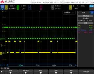

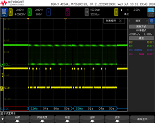

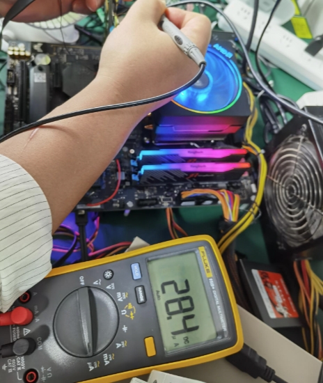

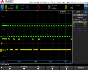

    Today, we focus on writing and measure IQ, the result as  bellow:
    1. using multimeter to measure IQ: the value always keeps at 28.4uA;
    2. follow the writing sequence you provided above, we can catch the right writing waveform, but we didn't see any change in current value, it always keeps at 28.4uA. the waveform as bellow.
    Zoon IN: writing 0x04 "8000"
    Zoon IN: writing 0x01 "0400"
    After writing 0x04 "8000" and 0x01 "0400", the waveform shows good, but we didn't see any change at current value(it always keeps at 28.4uA.)
    Please help to check what is going wrong? we need to set TMP117 go to shut down mode as default.
