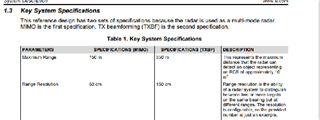

In User's Guide, Radar spec related with detection range is not written.
Please tell me detection range in each RCS and show me evaluation result if it possible.

  • I believe for the cascade EVM, the max range spec is given considering the RCS as described.
    You can refer to the following document for more information on that.
    Imaging Radar Using Cascaded mmWave Sensor Reference Design (Rev. A) (ti.com)
    Kaushik

    The data presented in this design guide was obtained
    using MMWCAS-RF-EVM Revision C, that used the
    AWR1243P devices.
    I want to know the spec the latest MMWCAS RF-EVM Revision D makes use of the second generation, AWR2243 devices.
    Please tell me the difference of the detection range between the MMWCAS-RF-EVM Revision C and Revision D.
    and introduce the document about Revision D, it there are.
    We do not have a similar characterization done with the AWR2243 device-based cascade EVM but the numbers should be easily met by the AWR2243 as well. (Also, the AWR1243P was not productized).
