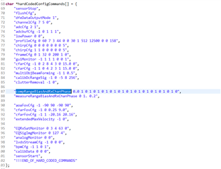

0. Implementation possibility.
- is it possible to create a radarcube using BPM in AWR6843AOP like AWRL6432?
( Tx1+ Tx2 / Tx1-Tx2  )
Addition and subtraction method using phase difference
1. BPM
i want to use BPM because there is an SNR gain.
i am trying it using that profile.  (  profile-2dbpm.cfg), So i would like to check if radar transmission method operates in BPM ,
is there a way to check?
2. Using 3 Rx antenna.
AWR6843AOP has 3Tx / 4Rx, but i would like to use 2tx / 3Rx.
is it possible to use 3Rx?
Accroding to rangeprohwa code ( Screen shot) , It i use 3 Rx, the error occurs.
Please share your opinon.
BEST Regards
JINHYUN JEONG

  • Hi Kristien,
    About Question 2, AWRL 6432 also has 3 Rx, i don't understand why EDMA works on even RX antennas.
    i think the ADC buffer for the 6432 will be formed as above, isn't it?
    (The adc value will be a complex value, unlike 6432, but in range dpu only real values among the complex value will be performed by HWA.)
    i also optimized virtual antenna like 6432.
    +) Could you also check the profile for BPM method?
    ChannelCfg 7 5 0
    (Tx0 / Tx2 Enable  | Rx0 / Rx1 / Rx2 Enable)
    Chrip Cfg
    0 0 0 0 0 0 0 5
    1 1 0 0 0 0 0 5
    (Tx 0 / Tx 2 Enable)
    Bpm cfg
    -1 1 0 1
    If i set it like this, is is correct that the opposite phase of the first chirp is transmitted in the second Chrip?
    Best regards
    JINHYUN JEONG

  • Hi: Jinhyun:
    It seems that you are trying to enable the 6843 in complex mode, and then use only the real portion of it.  But this is not the right way.  Because the ADC output in real mode is not equal to the real portion of ADC output in complex mode (there is some frequency shift and downsampling in ADC complex mode in digital logic).
    You will need to program the AWR6843 ADC in real mode.  But the AWR6843 demo does not really support real ADC mode.   Let us continue the discussion through email thread.
    Inside AWR6843 OOB demo (with DSP), the bpmCfg is supported.
    1) With this bpmCfg CLI, the RF frontend will program the BPM chirp configuration through MMWave_addBpmChirp
    2) at the same time, the signal processing chain will support bpm demodulation (in doppler FFT procedure).
    As the AWR6843AOP OOB does not support bpmCfg, it does not really enable bpm mode in radar frontend, nor apply bpm demodulation in the signal chain.  So, you will need to add the support yourself in the similar manner as in AWR6843 demo (with DSP)
