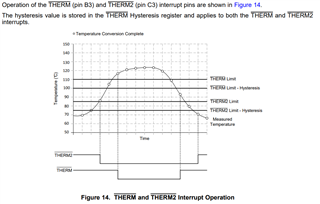

    That was a typo. I meant TMP468. I assuming you mean THERM2. I'm not seeing issues with what is shown in this thread. I'm curious if the circuitry attached to the shutdown signal could be latching itself. The definition of hysteresis is below:
    Meredith McKean
  • In our board we are using THERM pin as warning LED and THERM2 pin for shutdown. Therefore limit for THERM2 pin is higher than THERM pin. I don't see any issue with it but why does it work with some hysteresis value ? if circuitry to THERM2 is latching itself then it would latch all hysteresis value right ?
