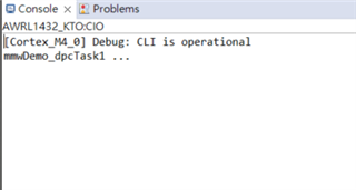

Added a new task and it works abnormally!
I referred to the sample code (radar_toolbox_2_00_00_06-Kick_to_Open) and modified Predefined Symbols => SOC_XWRL64XX.
Modify the following parts in mmw_cli.c
TaskHandle_t gDpcTask1;
StaticTask_t gDpcTaskObj1;
StackType_t gDpcTaskStack1[128] __attribute__((aligned(32)));
void mmwDemo_dpcTask1();
#define CLI_BYPASS 1
DebugP_log("mmwDemo_dpcTask1 ...\r\n");
while (true)
vTaskDelay(500 / portTICK_PERIOD_MS); // Block for 500ms.
int32_t CLI_MMWStart(void)
gDpcTask = xTaskCreateStatic(mmwDemo_dpcTask, /* Pointer to the function that implements the task. */
"dpc_task", /* Text name for the task. This is to facilitate debugging only. */
DPC_TASK_STACK_SIZE, /* Stack depth in units of StackType_t typically uint32_t on 32b CPUs */
NULL, /* We are not using the task parameter. */
DPC_TASK_PRI, /* task priority, 0 is lowest priority, configMAX_PRIORITIES-1 is highest */
gDpcTaskStack, /* pointer to stack base */
&gDpcTaskObj); /* pointer to statically allocated task object memory */
configASSERT(gDpcTask != NULL);
gTlvTask = xTaskCreateStatic(mmwDemo_TransmitProcessedOutputTask, /* Pointer to the function that implements the task. */
"tlv_task", /* Text name for the task. This is to facilitate debugging only. */
TLV_TASK_STACK_SIZE, /* Stack depth in units of StackType_t typically uint32_t on 32b CPUs */
TLV_TASK_PRI, /* task priority, 0 is lowest priority, configMAX_PRIORITIES-1 is highest */
gTlvTaskStack, /* pointer to stack base */
&gTlvTaskObj); /* pointer to statically allocated task object memory */
configASSERT(gTlvTask != NULL);
gDpcTask1 = xTaskCreateStatic(mmwDemo_dpcTask1, /* Pointer to the function that implements the task. */
"dpc_task1", /* Text name for the task. This is to facilitate debugging only. */
128, /* Stack depth in units of StackType_t typically uint32_t on 32b CPUs */
0, /* task priority, 0 is lowest priority, configMAX_PRIORITIES-1 is highest */
gDpcTaskStack1, /* pointer to stack base */
&gDpcTaskObj1); /* pointer to statically allocated task object memory */
configASSERT(gDpcTask1 != NULL);

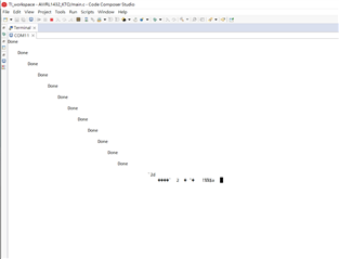

mmwave has stopped? Adding a task should be a basic function! What's wrong?
  • Hey Johnny,
    Make sure to change all libraries to xwrL64xx instead of xwrL14xx by right clicking the project, selecting Show Build Settings -> Build -> Arm Linker -> File Search Path and changing the relevant library files. Check the Build -> Arm Compiler -> Include Options as well for any other device references that need to be changed. You may also need to increase the priority of the new task to a non-zero value. Additionally, I would recommend using the CCS debugger to check where the program could potentially be hanging up and letting us know what the call stack is if its crashing or stalling.
