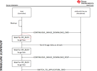

I am trying to flash 6432LAOP via SPI and read the following diagram in swru599a.pdf
Woud you pls give me the specific PIN num corresponding to the SPI_BUSY in the diagram?

Hello Tony.
Sorry for the delay in response. I believe the SPI_BUSY is not a pin but a bit in the QSPI registers, specifically the [0] bit of the QSPI_SPI_STATUS_REG indicating if it is busy or not. Please refer to the QSPI registers in the TRM for more information.
