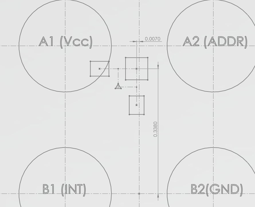

We have question about mechanical position of hall element in the case.
Datasheet indicate 0.25mm from top but 0.25 ± XX ? What are the min and max value ?
Same question for other parameter: position from the side of the case.

  • Hi Aymeric,
    Apologies for the delayed response, we are still talking to our packaging team regarding your question about the package's outer tolerances. However, I have some new information regarding the hall element placement relative to the device's pads.
    Below is a top-view image of the package with the hall elements circled in green. Since this is a DSBGA package, the midpoint between the centers of balls B1 and B2 is the die center. This will be the new reference point for the hall sensor placement.
    As described in the image, the Z element center is offset 7um on the horizontal axis and 338um on the vertical axis. As for the placement of the X and Y hall elements relative to the Z axis element, please refer to the following diagram:
    The X element is 99.9um away and the Y element is 98.7um from the center of the Z axis. This image is using the same coordinate system as the first image. I'm still working on getting the packaging tolerances clarified, and I'll let you know once I get that information, if you need it. Hopefully with the provided measurements you won't have to calculate the hall element location based on the package's edges.

  • Hi Aymeric,
    I'm glad I could help. Since the package is die-sized, the ball grid is manufactured to the same tolerance as the silicon, meaning that the expected tolerances of the hall elements' positions relative to the balls are very small (<1um). If you base your placement off of the midpoint between B1 and B2 you should have plenty accuracy given the sensitivity of the device. With regards to the tolerances of the outer edges of the package, I am still waiting on new information from the packaging team. My apologies for the delay.
  • Please note that the image above posted above had the 7um offset from center applied in the wrong direction.
