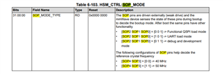

SOP2 SOP1 SOP0
0 1 1
In the above mentioned method of booting, the image will be loaded from UART of QSPI external flash ?

Hi Thiru,
In SOP2 mode (No-Boot mode), the ROM will not execute, you need to have some sort of gel scripts or a way to initialize the clocks,pll and memory, and then you can load your application image directly to RAM.

Hi Shruti,
So in this case, we cannot load and execute SBL from external flash ??, is my understanding correct ?.
If we want to load SBL from External flash is there a way ?.

Hi Thiru,
You should have a gel script which will first initialize the clocks, and other things which ROM supposed to initialize, after that you can load any image directly to the RAM.
You can use SOP4 and SOP5 as well, is there any specific reason why you are not using those?
