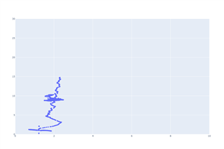

Below is the attached video if you observe the sensor is mapped on the truck with a holder and we were doing some tests. The sensor is super sensitive even with slightest of the tilt. We mapped the target data alone and you see that even when the person walked straight as we go away from the sensor there is a deviation on the X axis. The person who started at 1.6 and by the end he ends up 2.3. Why is it that the dynamic points and target data are drifting as we are walking away from the sensor but while walking towards the sensor we do not have any problem. How can we solve this problem? I will be glad to hear from you a solution.

    Is the truck moving or is the engine on when the measurement is running? Can you share a video of the scenario? Perhaps the board is tilted in the x-direction?

  • Please also tell us what configuration file and binary you are running on the device.
    Nate
  • Hi Nathan,
    Thanks for the reply. We are using 3D people tracking bin file and here is the configuration file:

    I have also ran this configuration file on TI Industrial Visualizer and it is the same, there is a drift.
    Divya Teja Settimali
    Please show a video of the setup and the visualizer running. Is it possible there is a multi-path or the sensor is tilted?
