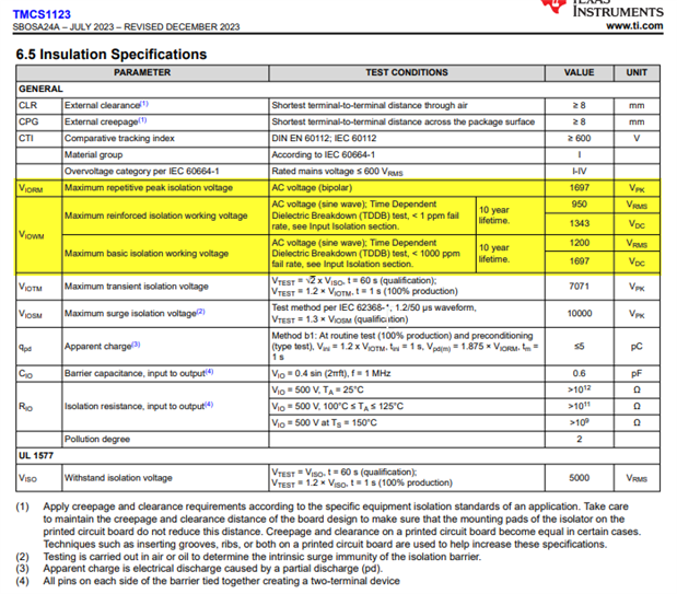

We're looking at the TMCS1133 due to its TMCS1133 1MHZ BW and the ±1300V reinforced isolation that's listed on the webpage.  But when I download the datasheet i noticed it doesn't have the 1300V reinforced isolation listed similar to the TMCS1123.  Is this in error?
Thank you.
