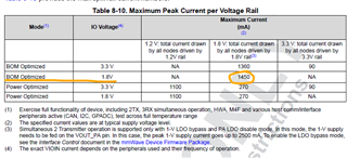

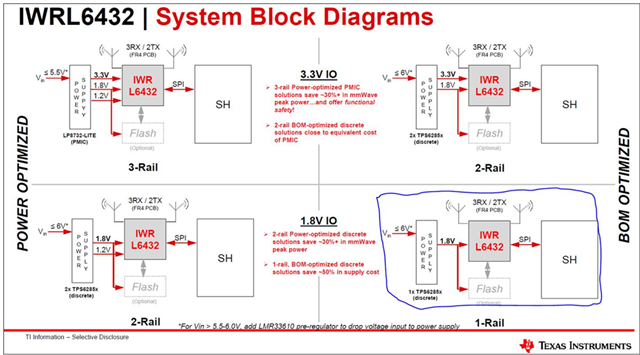

A customer has decided to do a custom board design using the IWRL6432AOP and wants to configure the system with a 1.8V single source power supply as shown in the following diagram.
I would like to ask for a design guide, if there are any constraints or things to consider such as performance and low power implementation when configuring only 1.8V power supply.
Also, the diagram below is for IWRL6432, but I would like to know if the same applies to IWRL6432AOP.
