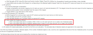

  • Hello Kaushik,
    Thank you for your information. Could I ask you some more questions?
    > Here, I'm not sure if I am able to find the peak search method selection as you mentioned between HWA stats block or CFAR block.
    --> I have found your document about multi-object peak search of 2D(azimuth/elevation) FFT caluculation. (Please see the following image.)
      ti/mmwave_sdk_03_06_02_00-LTS/packages/ti/datapath/dpc/dpu/aoa2dproc/docs/doxygen/html/index.html
     The MultiObjBeamforming in mmWave_sdk_user_guide (mmWave demo) can switch HWA statistics block or HWA CFAR, right?

  • Hi Shoko-san,
    Thank you for the clarification. I was looking at the aoaproc DPU as opposed to the aoa2dproc DPU, but the mechanism should hold.
    From what I understand, it looks like after the azimuth and elevation FFT are performed in the aoa2dproc, you can either choose the CFAR based peak estimation, or the stats block based peak estimation as part of the 'multiobjbeamforming' operation. Here are some of the key differences:
    • When you use the CFAR based peak detection from the azimuth FFT, the number of peaks you obtain will be greater than 1 per FFT sequence. In the case of stats block, it will always be 1.
    • This method yields a greater number of detections in the case of multi object beamforming being enabled.
    • It can increase the total number of detections stemming from say an object with a very large area and instead of it being represented as a single point object in the point cloud, there will be multiple points mapped to the same object.
    Based on these details, it should be able to choose the right method for your use case.
