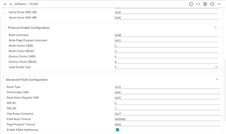

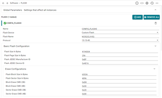

The flash was changed to W25Q32, and the sbl and the application also made corresponding flash modifications, and the burning error occurred:
[ERROR] Cortex_R5_0: XMODEM recv failed, no response OR incorrect response from EVM OR cancelled by user,Power cycle EVM and run this script again !!!
Hi JX,
Did you make the modification in sysconfig of SBL and application for new flash that you are using?

Hi JX,
Can you disable 4 bits addressing? and try building it again?
BR,
Animesh Anand
