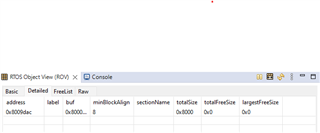

I have a very simple main code as shown below. When I try to debug this code, I see the stack overrun and heap has no free memory. I am using mmWave SDK or BIOS functions as it is.  Can you help me debug this further. All the details are given below

Cfg file is as below

    We do not help debug custom software on this forum. Can you start with the one of the drivers projects, maybe the GPIO or something small, and see if that works?
    Nate
  • Hi Nathan,
    My final requirement is to do a custom Code debugging. However the steps mentioned in previous mail, I gave is simplified code which only have TI code. If you see my main() I only have 3 function ESM_init(0), SOC_Init(0) and BIOS_Start(). All 3 functions are taken from mmWave SDK.. The config file used is also taken from mmWave OOB demo as it is. Is there any other factor that can contribute to the memory overflow and no heap memory available.
    I tried drivers as you mentioned earlier however I got into multiple issues for which I have created seperate queries. But i think both the issues are mutually exclusive and hence simplified the code for better debugging.
