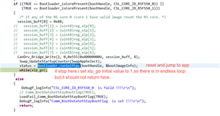

Hi,experts
When i ready to jump from bootloader to app,I call Bootloader_socCpuResetReleaseSelf,but it didnt do soft reset,and return SystemP_SUCCESS.Not always occur,i tried to test many times,Low probability occurrence.

Hello Xiang,
Can you disconnect from the debugger and run the same application.
Connecting to the debugger and trying resets will cause some error like this.

Hello Xiang,
Can you tell me what was wrong?
Keep the while loop and disconnect from debugger and run it a few times and see if it is hitting that breakpoint.

Hello XiangLiping,
If that is working for you, please do go forward with that as it is fine to call it twice.
Did you try the disconnect from debugger and check if that is fine?
