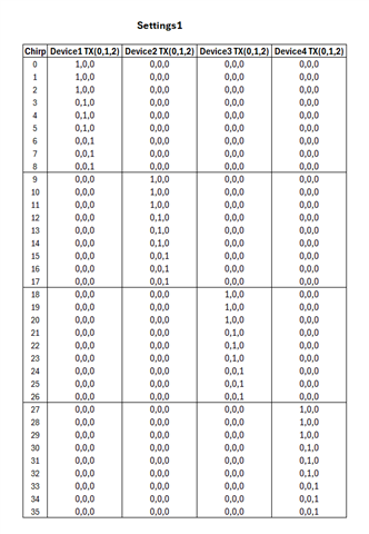

  • Hi Animesh Anand,
    Thank you for your reply. Actually I have already read that document. I will give an example.
    According to picture there is 2 devices. With first chirp Device 1's Tx1 is active. With second chirp Device 1's Tx2 is only active.After 3 chirp, with 4 th chirp Device 2's Tx1 is only active. I got MIMO logic.
    My questions are :
    1. Is there any way to start first active device as "Device 2" and activate Device 2's Tx1. Assume there will be 4 Device and I want to activate Device 4's Tx1 with 4th chirp. If this configuration possible How system can Device awares that it should activate it's Tx one by one.
    2.Is there any way to keep active these Tx by following couple of chirps. Assume they will active following 5 chirps. From chirp 0 to chirp4 Device 1's Tx1 will be active and from chirp 5 to chirp 9 Device 1's Tx2 will be active
    I want to learn how should I set these settings and want to learn how system works at behind.
    Thanks in advance

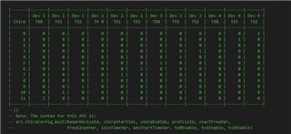

  • Hi Cemal,
    For your 2nd question, there is chirp configuration parameter that you need to set for chirping from a particular Tx.
    In the given picture you can see for chirp 0, it will only use Tx1 whereas for chirp 1, it will use Tx3. So, you can set it like that for each set of chirps. For more information about chirp configuration. you can go through mmwave user guide.
    mmwave_mcuplus_sdk_user_guide.pdf

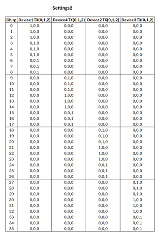

  • Hi Animesh,
    Actually I am asking how specific Device understand it is Device 1 or Device 2 or etc.
    Also question includes :
    Is it possible to arrange settings like Settings 1 and Settings 2. I could not understand when Device will start activating its Tx antennas.
    When you look at settings 2 Tx order has changed. Is that possible ?

    Sorry for delay, here you can find pictures
    This is settings1
    and this is settings2

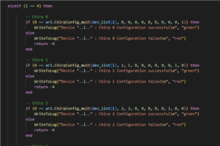

  • Hi Cemal.
    This is the Lua script for 4 chip cascade configurations. In the following example you can see how they have configured for the given example.
    here you can see the first chirp is coming from device 4 from Tx2. Second chirp is coming from Tx1 and so on for device 4. So, you can set it according to your requirement.
    https://e2e.ti.com/cfs-file/__key/communityserver-discussions-components-files/1023/Cascade_5F00_Configuration_5F00_MIMO.lua
