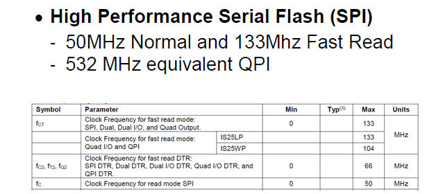

I read that for the IWR6843 only the IS25LP080D from ISSI
can be used for the IWR6843, whereas the IS25LP032D cannot (see screenshot).
We are currently using the MX25L3233F from Macronix and would like to have a
second source. At first glance, the IS25LP032D seemed to make sense.
But of course only if this is technically possible.
Could you please let us know if the IS25LP032D is really not compatible with the
compatible with the IWR6843?
We have also tested the IS25LP032D and it seems not to work on the IWR6843.
The data sheet says 50/133 MHz (see screen shots). I therefore thought that the component could be used.
However, we may have overlooked something else, e.g. in the register settings.
Maybe you could ask your colleagues if the IS25LP032D has been tested together with your IWR6843.
Then we would know exactly.
