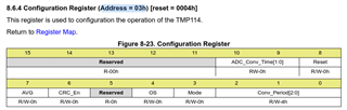

Hi TI team,
Need detailed step by step information on reading temperature from this sensor tmp114.
Getting the output as FFFF.
when i tried to write configuration register address - 0x03 's value as 0 and trying to read from the sensor writing to 0x00 and reading from that.
I'm attaching the base c code that we tried.

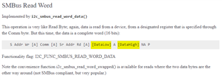

  • Reads from TMP114 must be performed as one Write-Restart-Read transaction. This is different from most of the TMPxxx sensor portfolio. You may need to use SMBus Read Byte or Read Block commands to achieve this.

  • You need to use SMBus Read Word as described in the Linux documentation. https://docs.kernel.org/i2c/smbus-protocol.html

    Just need to confirm the procedure I am following to read the temperature from the tmp114
    -> The first thing to do is to configure the sensor so i am writing the data as 0000(required configuration bits) for the configuration register 0x03.

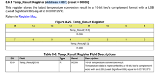

    -> Then i am trying to read the temp data by giving the register address as 0x00 (TEMP_RESULT) register.
    My doubt here is, Do i have to write something to the TEMP_RESULT register to read the data from that same register?
    Because its mentioned TEMP_RESULT register type is 'R'. So i just need to confirm the procedure that i am following is in the right path? or any changes in the way i am reading?
  • The first byte transmitted to TMP114 in a write transaction is always the register "pointer." The register addressed by this pointer will be written to by any subsequent bytes in the transaction. The I2C transaction can have an arbitrary number of bytes dependent only on the controller's will to continue clocking them. Of course, many target devices will just stop taking any action with the bytes beyond a certain number.

    If a 2 or 3 byte write transaction were performed on TMP114 using zero as the Data1 pointer byte, nothing will happen. As you've pointed out, the Temperature Register 0 is not writable, so Data2 and Data3 will not actually be stored by TMP114.
    Most of the TMP portfolio of devices will retain the pointer byte written to them until power cycled. This means a single write transaction of S,Addr+W,A,Data,A,P could be used to set the pointer to the Configuration register, and from then on all read transactions of the form S,Addr+R,A,Data,A,P would return one byte of data from the Configuration. For this reason, it is customary to always set the pointer to the register you wish to read using a write transaction prior to performing any read transaction. This way you will never get data from an unexpected register.
    However, the TMP114 will not retain it's pointer. All read transactions with TMP114 must be of the form S,Addr+W,A,Sr,Addr+R,A,Data1,A,Data2,A,P. This is accomplished by the i2c_smbus_read_word_data() in the previously linked documentation. https://docs.kernel.org/i2c/smbus-protocol.html Since this Write/Read action must occur together in hardware timing, it can only be triggered by specific software function. It cannot be triggered by individual write and read software functions.

  • The data returned by SMBus Read Word is byte swapped, as described in the linked documentation. The documentation suggests using i2c_smbus_read_word_swapped() instead. This would also be apparent if you read the Device ID register, since it always reports 0x1114. All of your reported temperatures are about 26C.
    ren
  • Hi ren,
    Thanks for the support, it worked.
