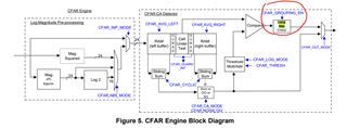

  1. Based on the SDK, there is no parameter to change CFAR local Max detection on/off. How can we make it possible to set to detect only Local Max point? Is there is any hidden parameter inside of TI SDK?

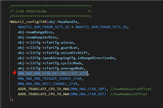

  2. Wed like to check if there is the limitation of number of max points in CFAR.
    1. What is the max number in AWR1443 SDK?
    2. If there is available method to change the number of maximum CFAR target, please let us know how to manipulate it.
  • Hi Eom,
    Please find my responses as follows:
    1. You can control the peak grouping as follows:
      1. Please note that there are no hidden parameters. The HWA user guide fully describes the configuration and control that can be exercised on the HWA
    2. You can find the configuration of the detected objects list size here:
      1. The effective number of objects for which angle is computed will be obtained after the peak grouping is done following CFAR where we obtain
        numHwaCfarDetections from the peak count register. If you are just looking to obtain more points, you can do so by adjusting the thresholds. You also need to make sure there is sufficient memory available to hold the information of all these extra detections.
    Please let me know if there are any further questions.
