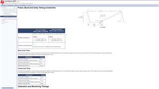

IWRL6432BOOST: The constraints on chirpTimingCfg and frameCfg settings
Part Number: IWRL6432BOOST
Where are the constraints on chirpTimingCfg and frameCfg settings?
I am testing using motion_and_presence_detection_demo.
With the settings below, I would like to reduce the BurstPeriodicity, but the firmware outputs an error if I set it below 180[us].
channelCfg 7 3 0
chirpComnCfg 8 5 0 256 1 28 0
chirpTimingCfg 6 63 0 35 60
frameCfg 2 0 200 32 250 0
